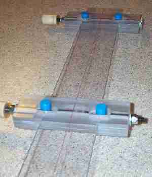

PostPosted: Tue Aug 22, 2006 3:31 pm
Posts: 3272
First name: Barry
Last Name: Daniels
Steve, Do you mean kind of like this? My plastic work on this
prototype was a little suspect, but the jig works very accurately.
BarryDaniels38952.0343055556
PostPosted: Tue Aug 22, 2006 3:58 pm
Barry, what a cool jig!

Barry--I wondered if you were reading this thread! I like the self-clamping feature of your jig also.
Nice work! Great minds at work here.
Nelson
PostPosted: Wed Aug 23, 2006 12:41 am
Posts: 3272
First name: Barry
Last Name: Daniels
I made my prototype using the hardware from a small wood handscrew clamp. It does act like a clamp, but it also tracks the centerline well. It also works on necks of various widths. I was gearing up for a production run, but when I heard that Tracy was coming out with his version I went back to making guitars.

[QUOTE=BarryDaniels] Steve, Do you mean kind of like this? My plastic work on this
This is exactly what I was envisioning. This makes a lot of sense and would be very to use. Good jig, Barry.
PostPosted: Wed Aug 23, 2006 7:28 am
Posts: 1969
prototype was a little suspect, but the jig works very accurately.[/QUOTE]Exactly like that. That looks good!
